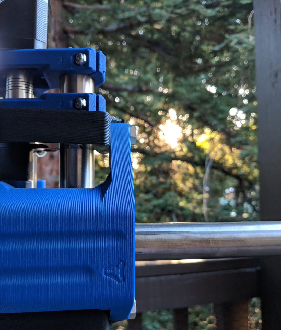

I would like to introduce you to the new “Burly” parts. It has been more than 2 years since the “525” (5/25/16) parts were released and I am very excited as I have been toying around with these ideas ever since. No new hardware is needed just some new printed parts, so, free update. How about a quick list.
Pro’s
- More rigid XYZ pieces, the main focus of this update!
- #6-32 and 4mm tool mount versions.
- The 5″ bolt now fits better.
- The Nut Trap is revised for #6-32 & 4mm screws.
- The Nut trap has a printed spring for easier use.
- The Nut Trap should work in all reasonably sized tubing and wall thicknesses.
- Smaller Individual part count.
- Stronger Z clamps with no added overall build volume.
- Tiny tweak to the corner spacers for a better fit.
- Lil more style, Subjective.
- No hardware changes from the “525” ** see below.
Con’s
- No more allthread parts, T8’s are the better option and cost difference in minimal.
- A little more fidgety to put together. I had to bury some of the nuts more to gain strength. These are nuts that should only need to be tightened once so really no big deal.
Upgrade Details
I suggest you reprint all the main center and Z axis parts, XY, XYZ, Spacers, and Z mounts. The tool mount is the same unless you want the hidden logo or 4mm nuts. The corner spacers are fine unless you are doing a rebuild than might as well. The nut traps are not dimension-ally different, so use what you have.
