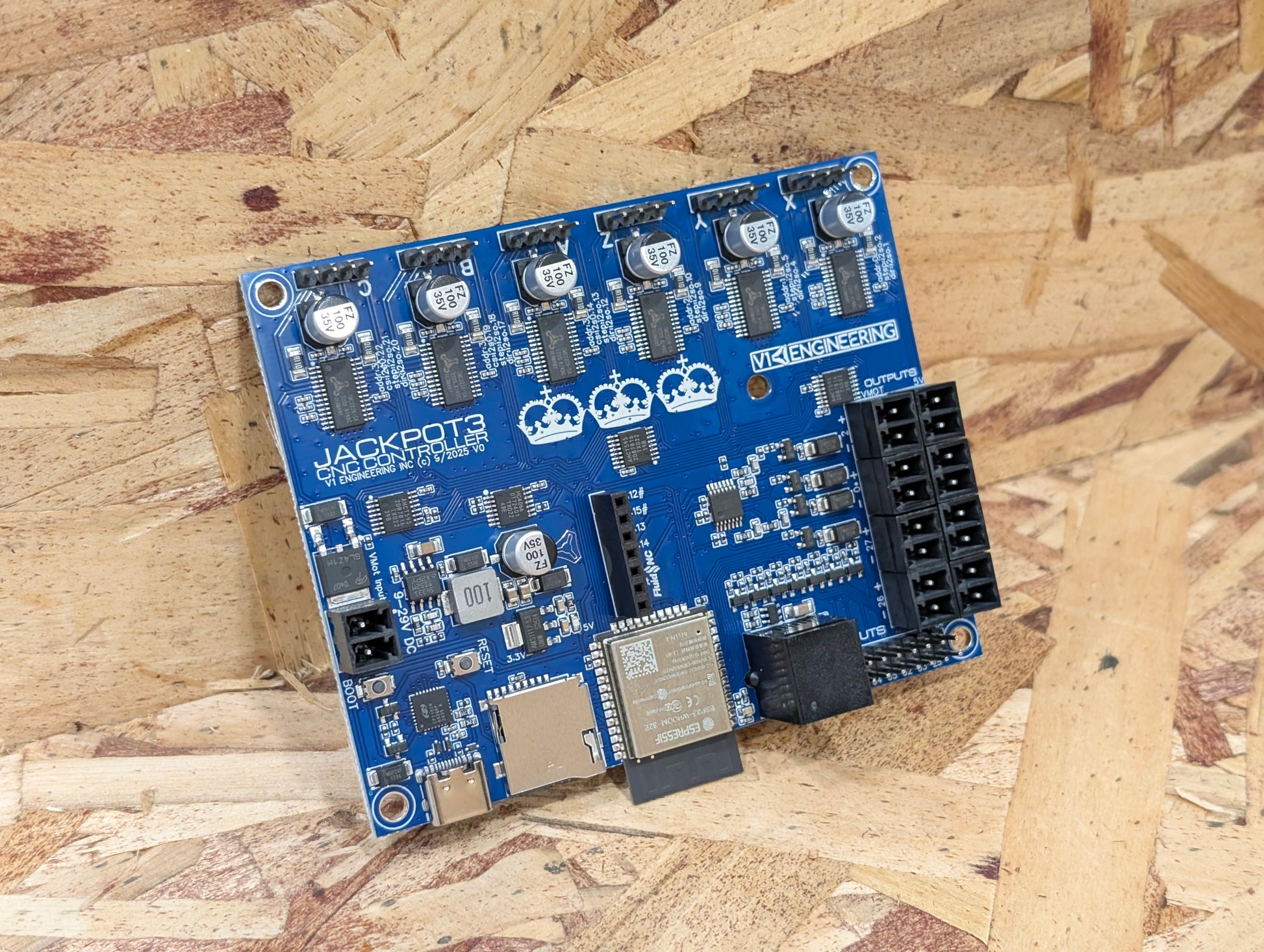

The Jackpot3 CNC Controller
Oh buddy, the best bang for your buck, expandable CNC control board out there!
Click here for all the juicy details  or click here for a Jackpot3 versus Original Jackpot feature list.
Includes;
  • 1 - Jackpot3 CNC Controller board (PCB color varies)
  • 5 - plugs
  • 6 - heat sinks (color varies)
 FluidNC firmware is LightBurn compatible.
Does not include a USB cable.
Fancy screwdriver for those small screws?
International users
What to save a little on shipping? You can now buy the Jackpot3 CNC Controller with more direct shipping from Elecrow
Details
The Jackpot3 CNC Controller is a 32bit dual-core 240mhz control board.
  • Built in wireless control software
  • WiFi, Bluetooth, or hardwired capable (esp32).
  • 6x TMC2226 drivers (nearly identical to the 22209 with better heat transfer)
  • 7 inputs, 4x 5V(full PWM capable) or 24V(PS input level) outputs (only basic PWM).
  • One expansion FluidNC module socket (more IO, or other specialty add on cards).
  • MicroSD card slot.
  • Integrated RJ11 socket, for a pendant or Airedale expander.
The Jackpot3 CNC Control board runs FluidNC which is fully GRBL compatible with extended features featuring easy configuration and updating, or GRBLHal (upcoming).
FluidNC
Between $1-$2 per board sold is donated back to the continued development and support of FluidNC.
Budget option - The Jackpot 2 is functionally identical without the fast output PWM, meaning if you do not plan on adding a laser, you can save some money.
Custom programmed on order for the LowRider CNC.
