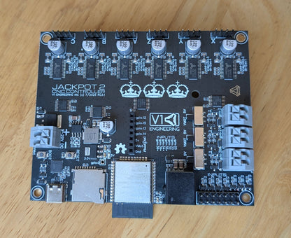

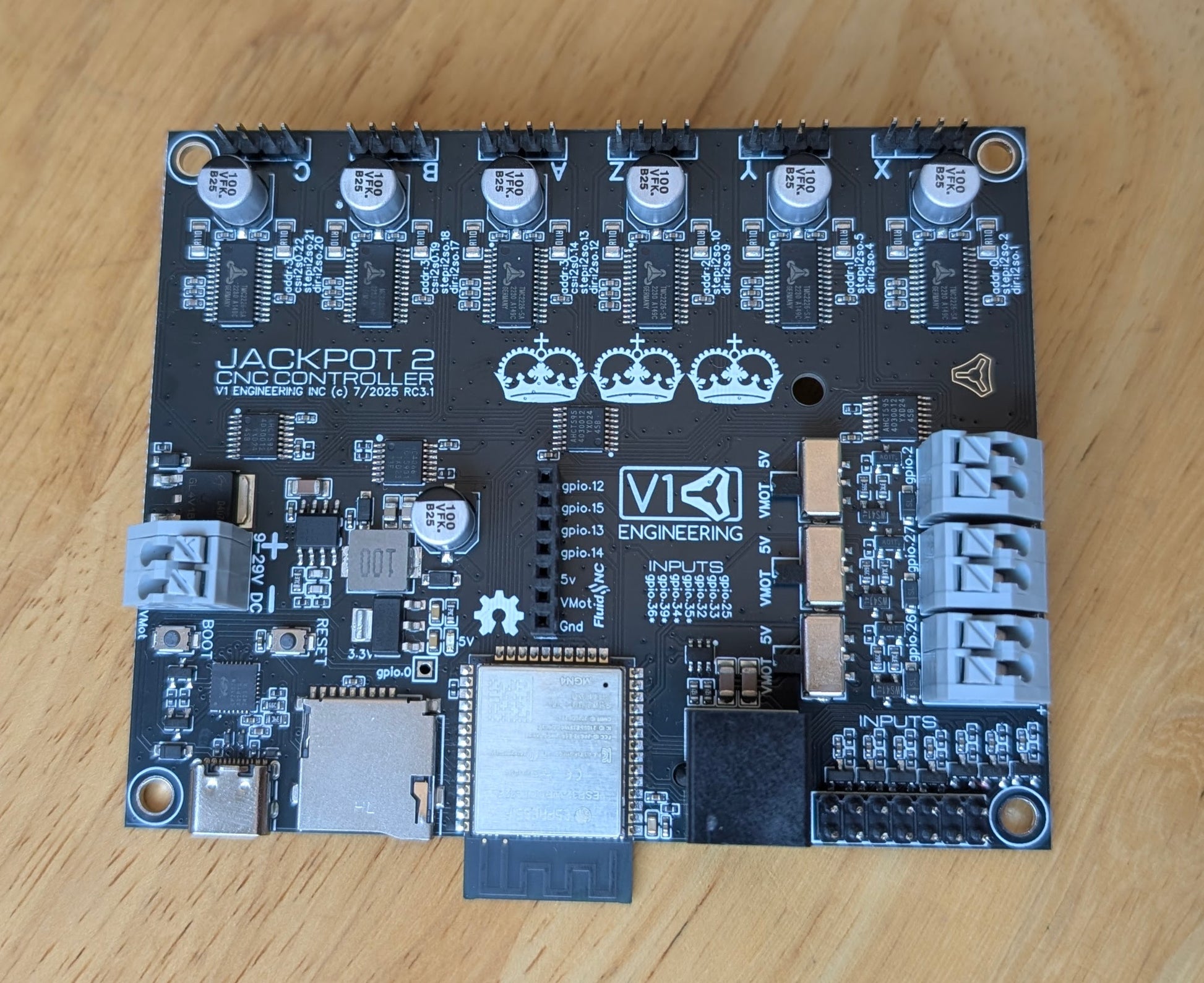

The Jackpot2 CNC Controller.
The Jackpot2 CNC Controller has integrated components, as compared to the original Jackpot's socket-based drivers and esp32. Integrated drivers helps with heat dissipation and saves some cost.
DANGER!!!! Please Read

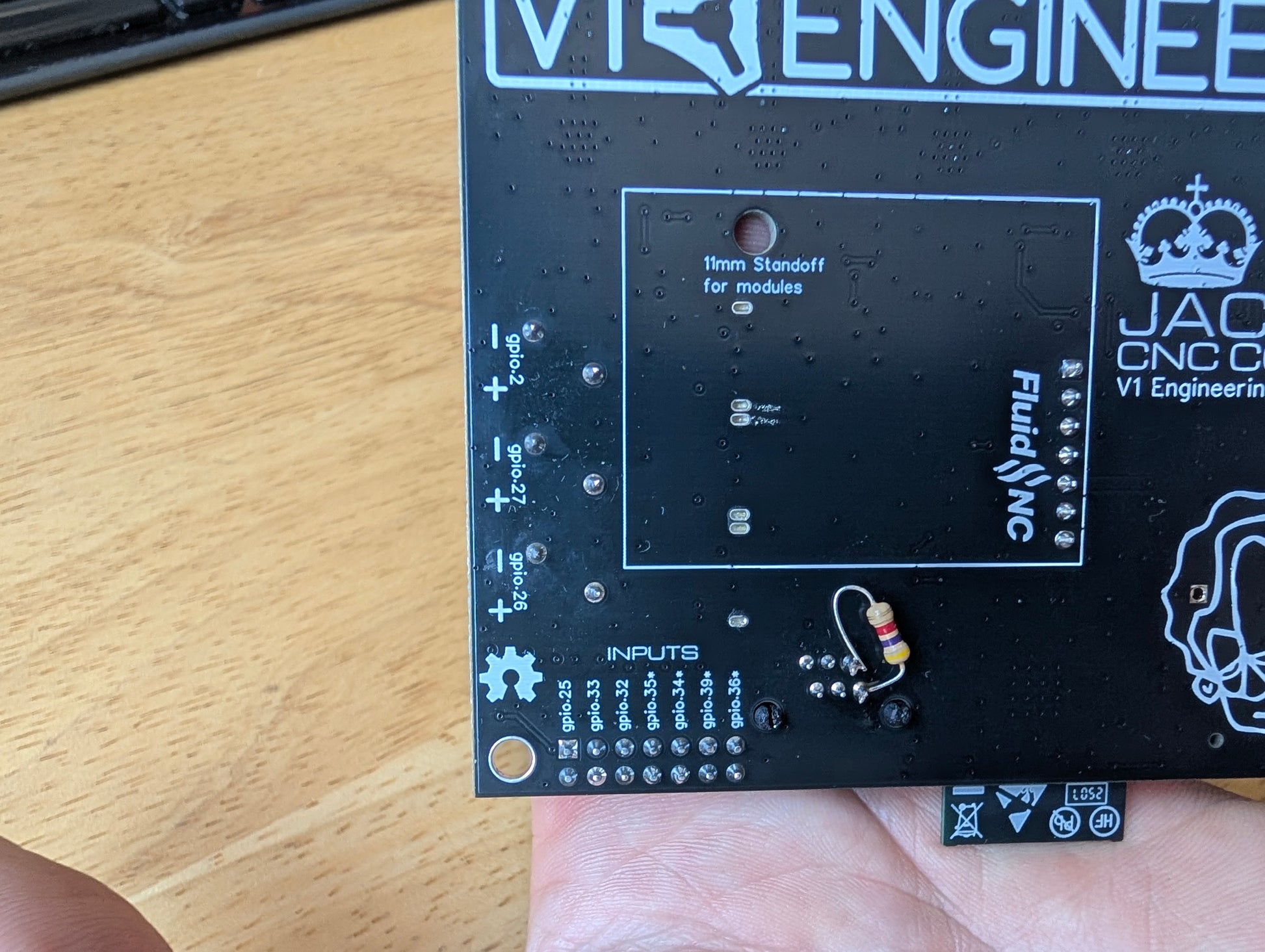

These are missing PWM capabilities on the 3 outputs. If you are looking to update a previous V1 board and are not using a laser, this is a great way to get an inexpensive new controller.
Not for the newbie!
1-These units will have a hand-soldered resistor on the bottom, shown in the picture. RJ11 pull-down.

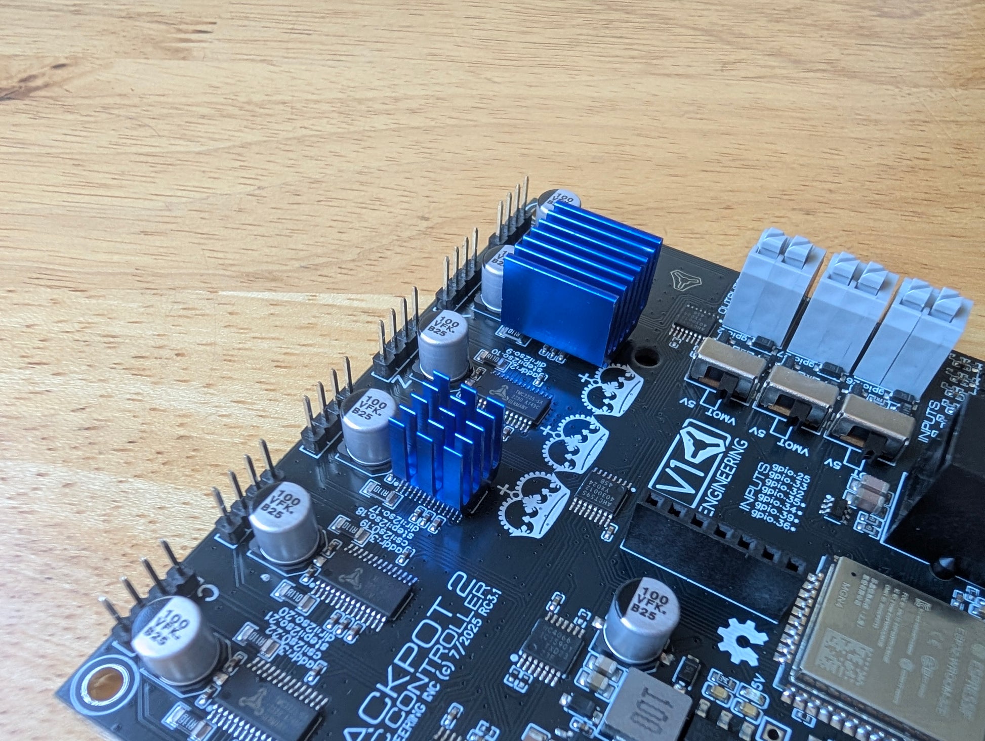

2-These will come with the standard smaller heat sinks.
Jackpot vs Jackpot2
The main differences between the first Jackpot and the Jackpot2 are integrated stepper drivers, integrated esp32, integrated RJ12 easier to use push to connect toolless power and output terminals, selectable output voltage, and USB-C. There are three voltage selectable outputs instead of the original Jackpot's 2-Vmot(24V) and 2-5V outputs. As well as seven broken out USB only IO for the power users.

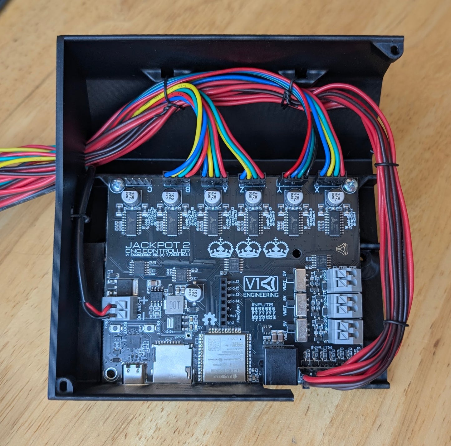

Printable Case
There is a box here, on Printables.com. This case has integrated cooling ducts in most environments I suspect no active cooling will be needed, of course if you live in a hot climate adding a fan is easy.
